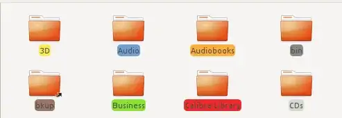

Can we some how use color labels on icons like OS X?
Something like this:

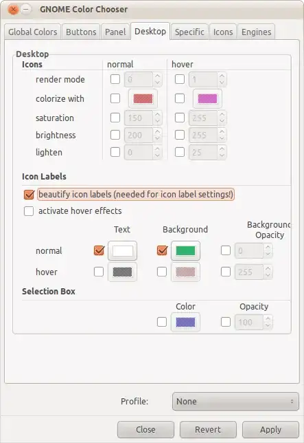

Install the gnome-color-chooser
package.
Open GNOME Color Chooser and switch to the Desktop tab.
Check beautify icon labels (needed for icon label settings!) and then set your label text and background colors:
Click Apply.

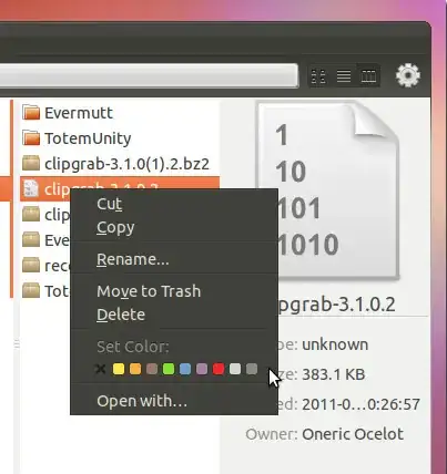

It is called Marlin File Browser
Installation of Marlin
Option 1: Marlin with Dropbox / Ubuntu One support
sudo add-apt-repository ppa:elementary-os/daily
sudo apt-get update
sudo apt-get install marlin marlin-plugin-dropbox marlin-plugin-ubuntuone
Option 2: what I have tested without dropbox/ubuntu one support
sudo add-apt-repository ppa:marlin-devs/marlin-daily
sudo apt-get update
According to the website, it is rather new and might have issue. Check out this article with some nice pictures showing how similar it is to Mac OS X file and folder color labeling.
Also, see this article for how to install it on Ubuntu 12.04 or 11.10 or on Linux Mint.
