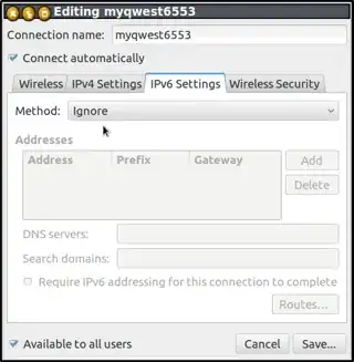

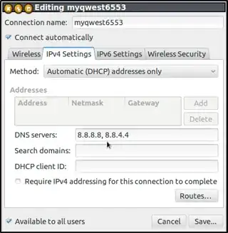

Do:
echo "options rt2800pci nohwcrypt=y" | sudo tee /etc/modprobe.d/rt2800pci.conf
sudo modprobe -rfv rt2800pci
sudo modprobe -v rt2800pci
that command changes encryption from hardware to software.
Do:
gksudo gedit /etc/pm/power.d/wireless
(this will create or edit a configuration file that will override the default power management behavior) and enter the following:
#!/bin/sh
/sbin/iwconfig wlan0 power off
above exit0, then save gedit, close.
Set your wireless settings in network manager to match the screenshots. wireless settings IPV6 settings
Reboot
