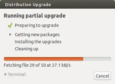

and three another options such as Show updates, Show Notifications and Preferences. I click on Show updates and now this window start to upgrade the Distribution

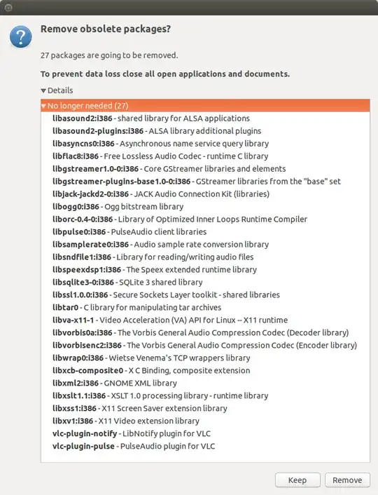

Now that finished with this window shown:
I choice Remove and popup window asks "restart to complete", and after restart I tried to install again this kernel but I get the same errors that I mentioned in above.
