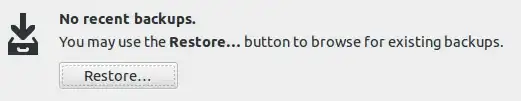

  1. Open Déjà Dup. Search the dash for deja.
  2. Click on the big “Restore” button.

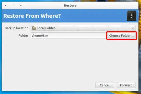

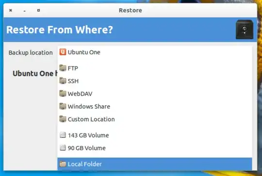

  3. A dialog will appear asking where your backup files are stored (your “Backup location”). Choose “Other…” and navigate to the folder of backups. On this same screen, select whether you encrypted the backup or not. Click “Forward”.
    enter image description here enter image description here enter image description here

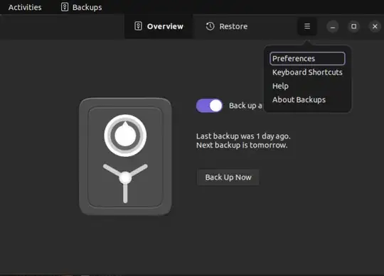

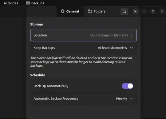

Déja Dup is called Backups in Ubuntu 22.04. After opening its window select the Preferences from the menu shown below. enter image description here

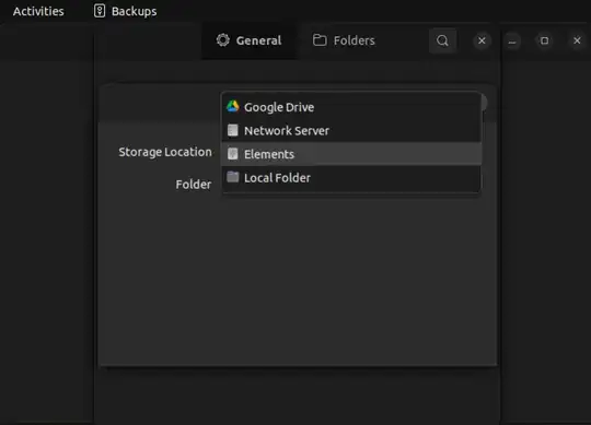

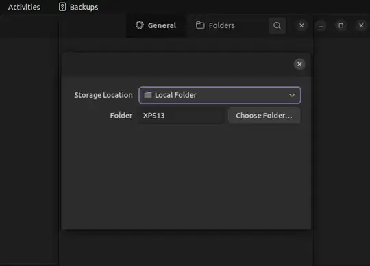

Then select Location in the dialogue window that comes up, shown below: enter image description here Navigate to the location of the files you want to restore by clicking on the box called Storage Location and then typing the folder name, shown next. enter image description here Alternatively, if the location is not shown and you don't remember the name of the folder, choose Local Folder and then click on the button Choose Folder... as shown next. That will allow you to navigate to the exact location with a graphical file manager window.

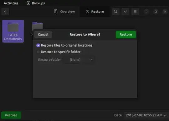

After choosing the folder to back up from (on an external disk or a remote location available to your host), click on the Restore button to select what folders and date to restore. As an example, I chose to restore all of the LaTeX Documents folder below. enter image description here When you click on the Restore button you will get prompted to choose the destination for the restored files. enter image description here Voilá, you are done. Enjoy your backups fully restored where you want or need them.
