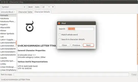

Another way:
  1. Install gucharmap (GNOME [Unicode] Character Map), if it is not already installed
  2. Run gucharmap
  3. Select "Kannada" under Unicode Block
  4. Find the character(s) you want, double click on each of them; they appear in "text to copy"
  5. Click on the "copy" button to put them into the paste buffer
  6. Paste into the document or file where you want the character(s) to appear
