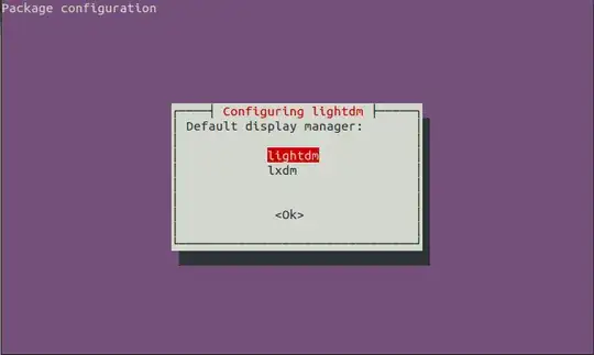

When I execute sudo dpkg-reconfigure lightdm in the terminal I see a simplistic window-like listmenu. Is there an way to make something like that in C++?
This looks something like:
The text-based window-like interface, contained within a terminal, that you see when you run sudo dpkg-reconfigure lightdm is coded using the ncurses library. So if you want your program to provide an interface that looks like that, you can use ncurses too.
