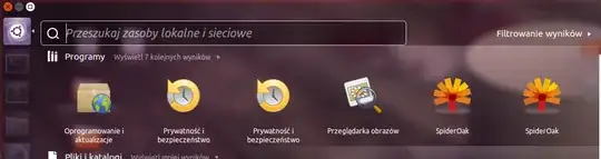

After upgrading to Ubuntu 14.04 from 12.04 I have duplicate entries in dash.
How can I get rid of them?

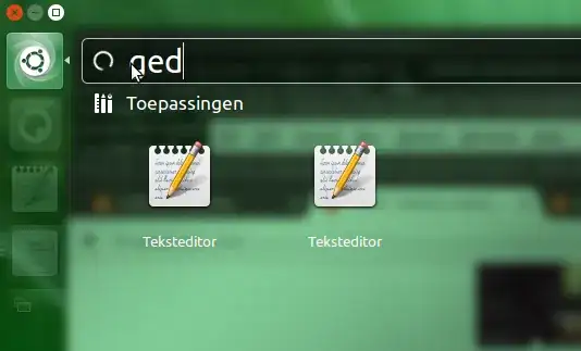

This is for example the result when I copy the gedit.desktop file, rename it to monkey.desktop and copy it into /usr/share/applications:
