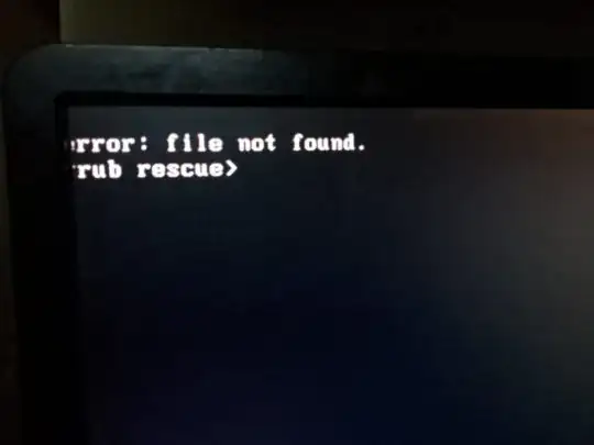

I have windows 7 my computer. Now i tried to install ubuntu 12.04 in my pc. after installting the ubuntu pc suddenly took restart and after that i see this image on my screen, when the pc starts. is there any way to solve this? i can not go into my windows 7 too. enter image description here

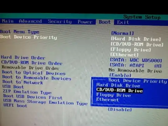

now i have inserted the ubuntu dvd to set up again.i go to the boot option and i clicked F12 but same erroor appears again. enter image description here

OK boot your live DVD and choose try Ubuntu, press the ubuntu button (top left) and open a terminal and enter these commands, one at a time.
sudo add-apt-repository ppa:yannubuntu/boot-repair
sudo sed 's/trusty/saucy/g' -i /etc/apt/sources.list.d/yannubuntu-boot-repair-trusty.list
sudo apt-get update
sudo apt-get install -y boot-repair && (boot-repair &)
When it is finished press the Ubuntu button again and search for boot repair, run this and choose recommended repair.
Follow any instructions given and when it is finished turn off your PC.
Remove the DVD from the drive, and turn it on, you will see all you oSs in a list after bios.

use a bootable usb with boot repair, or install boot repair using ubuntu live usb, https://help.ubuntu.com/community/Boot-Repair this link has the details
alternatively if you have a windows disk try this http://www.tweakhound.com/2012/11/13/how-to-fix-the-windows-bootloader/
good luck
