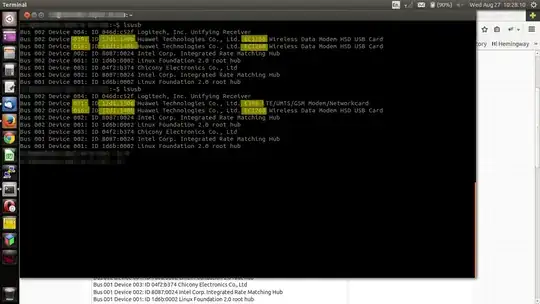

The product id is same because the modem chip used in both your (HTC) devices is the same.
I have 3 different USB dongle's, two of which have the same chip Huawei EC1260 and the third has Huawei E398. Please see my lsusb output in attached image.
Can't attach all three USB dongles at the same time, but you can see all three have different device IDs - 16, 19 and 21.
lsusb output showing same and different vendor/product IDs
