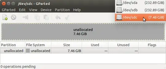

  3. Once gparted is open, switch through the devices to identify which one is the USB flash drive from which you are booted (skip if booting from cd/dvd/bd and have no USB storage devices plugged in)
    For instance, I have identified /dev/sdc as my USB flash drive by the size (roughly 8GB): My usb drive in gparted

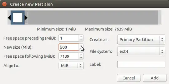

  4. Select the drive from which you wish to initiate the boot process, delete all partitions from it (you can use a right-click menu), and create a 500MB ext4 filesystem at the beginning of the partition.
    Note: I am creating these partitions on my USB drive for the sake of demonstration, but you want to create them on your primary boot storage device instead.

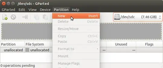

    Menu selection for new partition
    Note: After typing '500' into the "New size" field, I clicked the 'up arrow' next to the "Free space following" field once followed by a single click on the 'up arrow' next to the "New size" field to get a nice even 500MiB with the "Free space following" field automatically calcualted for me. It it is not really necessary to have exactly 500MiB here, though, so it won't hurt to be a few MiB off.

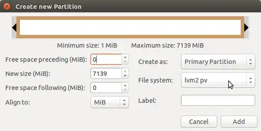

  5. After this, use the remaining space on your primary boot drive to create a partition of type "lvm2 pv".

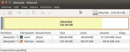

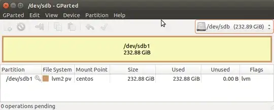

I am using 2x250GB HDDs in my installation. Here is what they look like in gparted:
Note: My pictures show that I have "mount points" specified; ignore this for now, as you will decide such configuration later.
My sda: sda final
My sdb:
sdb final
