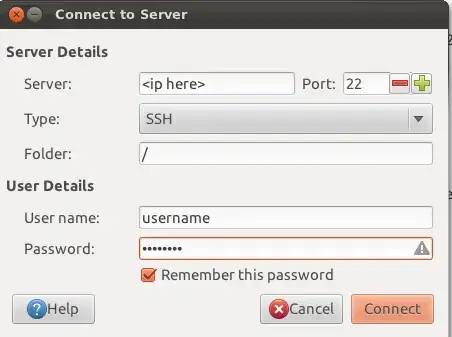

On the other computers do so in nautilus:
Menu
Dialog
Click connect and bookmark it like this
Bookmark
Similarly do the same for the other machines use the bookmarks to nagivate the other computers

Then you can mount the filesystem over SFTP (stands for Ssh File Transfer Protocol) in nautilus and copy that way just like you would between drives. To access files on the other computer, open nautilus and Clik the File -> Connect to server... menu. Pick ssh from the menu/list. Put in your username for the other computer and the IP for the other computer and click connect. It should ask for your password for the laptop username you put in and then it should show the files on the laptop. (You can do this in either direction.)
