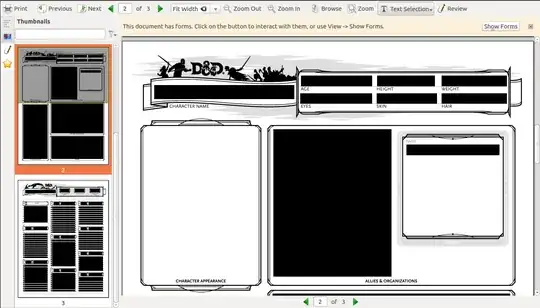

The PDF viewed in Ocular PDF Viewer.

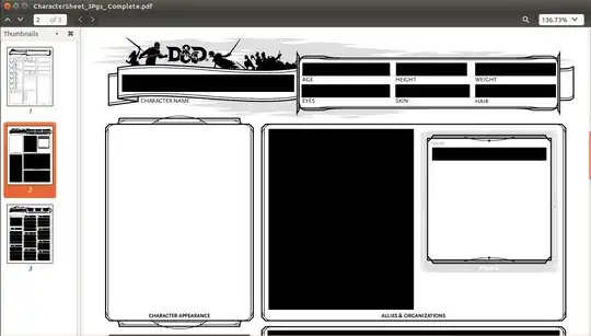

The PDF viewed in Evince Document Viewer.
This one is installed with Ubuntu 14.04, and on the side you can see the first page doesn't have the black bars.

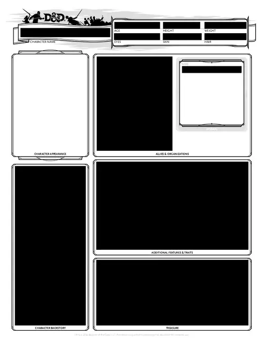

I exported the PDF to GIMP and saved the second page as a PNG, the black bars appeared in the editor.

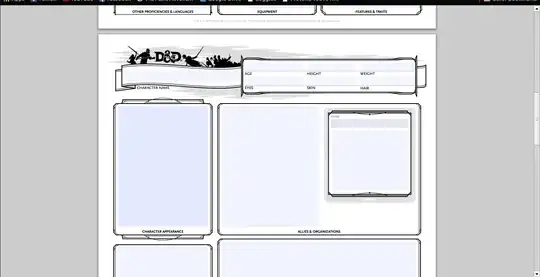

The PDF viewed in Google Chrome, the black bars don't appear here, indicating that it's likely a problem with Ubuntu.
Here is an imgur album of all the above images. In order, it shows the PDF open in Ocular, then Evince, then a PNG of the pdf exported to GIMP, and then Google Chrome.
