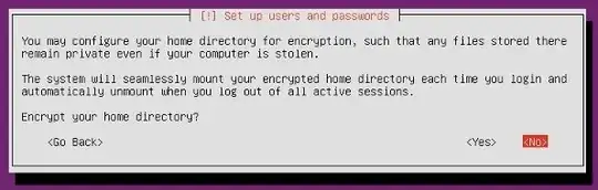

There seems to be two different steps in the Ubuntu Server 14.04 installation that involve encryption. The first asks if I want to encrypt my home directory:

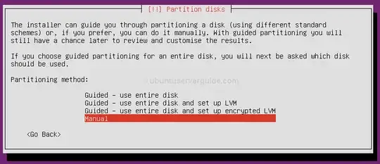

The second has an option for encrypted LVM:
Are these two different encryption procedures? If I do both is my drive doubly encrypted? Why would I do one and not the other?

They are completely separate and other then "encryption" they have nothing in common.
LUKS
LUKS / LVM encrypts everything but /boot.
With LUKS, almost everything is decrypted when you boot, /swap, /home, /, etc. You can of course configure this differently, but this is how the defaults work.
eCryptfs
eCryptfs or ecryptfs, in contrast, usually encrypts /home/username.
With ecryptfs, your home directory is decrypted when you log in. You would use this when you need to encrypt your personal data in /home separately from the system.
