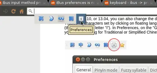

After installing IBUS and pinyin input method, I want to set the preferences for this particular input method. It should be something like "Using Traditional Characters in the IBus Pinyin IME" in this webpage.
But when I click the "Preferences" button in the floating window, as shown below, nothing appears. Clicking on Ibus icon and then "Preferences" does not work as well.
button
I tried with Pinyin and Sunpinyin, but neither gives a pop-up window. I'm expecting to a "Shuangpin" option in that window.

This issue is probably caused by python versions.
Don't modify ubuntu's default python version unless necessary, because that may broke various things, in my experience.
Try to run ibus-setup, to see what is causing the preference from starting. Then try to fix it.
In my case, it's because I have installed python3 (v3.9) via brew.
While the default python3 is v3.5, after install the system.
After uninstall brew's python via:
brew remove python3 brew uninstall --ignore-dependencies python3
Then re-open another terminal to take effect, then the issue is fixed.

To copy an answer from this Launchpad thread:
https://bugs.launchpad.net/ubuntu/+source/ibus/+bug/1730395
@KANGOD install python-ibus from trusy-update will solve the problem. i download one from https://launchpad.net/ubuntu/trusty/amd64/python-ibus/1.5.5-1ubuntu3.2, and install the deb with dpkg -i
Go to System Settings -> Text Entry, select Pinyin or SunPinyin and click the tool icon.
I had the similar issue with mint mate 17.2 which seems base on ubuntu 14.04.1.
Fix it:
And I fixed it by install python-ibus:
sudo apt-get install python-ibus
Then you can open the preference windows for sunpinyin.
As a summary:
When install ibus, you better use following command:
sudo apt-get install ibus ibus-table ibus-sunpinyin python-ibus
