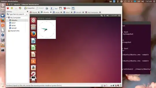

vmrun -T ws -gu username -gp password runProgramInGuest ./vmware/Ubuntu/Ubuntu.vmx -noWait /usr/bin/X11/xclock -display :0
As you can see from the picture below, this was successful
