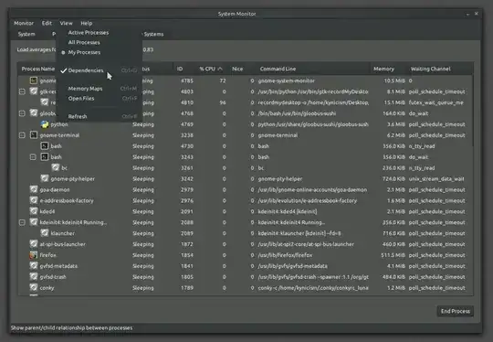

Another option is, to use System Monitor (comes pre-installed). In SM Menubar mark "Dependencies" option, under "View", to have a visual feedback, showing parent and children process(es) like show in the screenshot below.
I prefer the CL (Command Line) myself and suggest, that those who use Linux, in this case Ubuntu on a daily basis, wisely invest their time in learning the basic commands, over GUI Applications or at least are able to master both to a certain degree!
