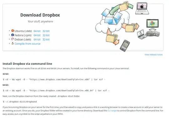

This morning, via email from Dropbox, I received notification that the version of Dropbox I am running on Ubuntu 14.04LTS will be retired next week and to update to the latest version. The email takes you to this page on their website:
Dropbox was initially installed using the Ubuntu Software Centre.
For the inexperienced user, is it best/easier to remove the package from within the USC and then re-install or is there a more elegant way of obtaining the update, for example using sudo apt-get update dropbox ?

This is the worst method, and the one you referred to in your question, also explained in the Dropbox installation instructions on Dropbox's website. Basically, to install it manually do
cd ~
wget -O - "https://www.dropbox.com/download?plat=lnx.$(uname -m)" | tar xzf -
(Again, slightly more elegant than what they tell you - this will work for both 32bit and 64bit). What this does is create a copy of the Dropbox client in your home folder. This installation is local (it can only be used by the user who executed that command), not system-wide. Additionally, updates will not be managed the package management system.

I would uninstall your current version through the Ubuntu Software Center. Then go to the link and download the .deb for your architecture (32 or 64 bit), and install that. That will add the repository to your system and updates will be install with regular system updates, when they are available.
I would download and install the deb, after uninstalling the old one. As the email says, there are important security improvements. Security updates are of the utmost importance and should be installed. If you wait for the repos to be updated, then you may be waiting a while.

I found that when I installed from the drobpox package repository (which at this moment provides the same deb as the one from the download link), I was unable to use dropbox - after entering my account details, the dropbox window reported in red that I needed to install an updated version from the web page indicated in the question.
When I downloaded and unpacked the tar.gz file and installed as per instructed, dropbox is working once again.
Note that with this version, you have to run it manually (or set up something to run it automatically). Also, to connect to your dropbox account, dropboxd writes a url to the terminal where you ran it. If you paste that url into a browser and enter you account login details, dropbox starts syncing your files.
I had to do one more thing: I have my local dropbox folder symlinked to another hard drive. dropboxd didn't recognise the symlink, created an empty directory in it's place and started downloading all my files (there are many!). I killed dropboxd, recreated the symlink and restarted dropboxd again and all's fine (well, it had to re-index everything, which took a while).
