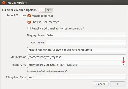

I want to mount my internal HDD at at startup (I boot from an SSD). I attempt to set this, following this procedure:
  1. Open Disks utility
  2. Select the disk
  3. Below the disk's Volumes, click on the More actions button
  4. Select Edit Mount Options...
  5. Select Automatic Mount Options "Off"
  6. Under Mount Options, ensure that Mount at startup is selected
  7. Click OK
  8. Enter password into Authenticate dialog box
  9. Restart
but this procedure doesn't work. Upon rebooting, and after Grub attempts to start Ubuntu, I receive the error message "An error occurred while mounting /mnt/4f721fc0-8072-453f-b48f-ca686bd89549. Press S to skip mounting or M for manual recovery". That identifier "4f721fc0-8072-453f-b48f-ca686bd89549" was automatically assigned by Ubuntu.
I press S and the boot process continues OK. If I try to mount the disk immediately after booting, I receive the error message "Unable to access "Storage"" (I named the volume Storage).
So then I start the Disks utility and set it to Automatic Mount Options "On" and reboot.
To me, it seems like this should work, but it doesn't.

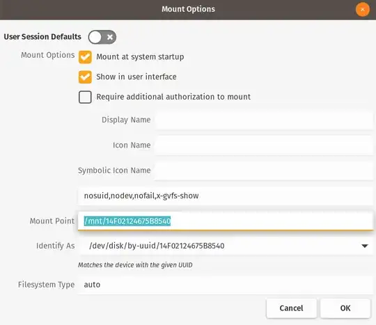

I was trying Sudheer's suggestion today. I tried all the different Identify As options to no avail, as every reboot showed that it wasn't working correctly.
What was happening was that the drive itself was mounting correctly, but all the bookmarks were broken (Folders with Yellow on the left panel), therefore I was lead to believe that the drive was not mounting at all.
Then I realised my mistake and found out that when you select an Identify As option, it will set the the Mount Point to a default value (e.g. /mnt/[uu_id]).
This is not the mounting point I desired (e.g /media/[username]/[MountFolderName]) and it was incompatible with the bookmarks I have set on the Files Application.
So you need to set the Identify As option first, then set the Mount Point to your desired location. I basically fell in the same trap as user el_gallo_azul above, but I was lucky enough to finally spot the missing step required.
So the Disks utility definitely can automount and you shouldn't have to modify fstab.
I'm using Ubuntu 18.04 with a front end skin (POP O/S 18.10)

Try changing "Identify As" to LABEL option.
