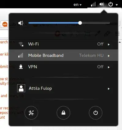

    Now you should be good to go and able to connect via the GUI:
    Ubuntu Gnome 14.04 Connect To Mobile Broadband
