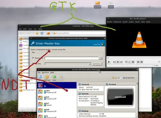

I use Xfce.
My problem is - some programs look nice and some sort of ugly. AFAIK this is because Xfce is GTK and most programs use GTK theme, but some programs use Qt and thus don't use GTK themes.
So - my question is - How can I apply some theme to these Qt programs? Can I download some qt theme and drop into ~/.themes? would that work? Qt programs don't have to look absolutely the same as GTK ones - I don't care about that. But I want them at least not to look so ugly.:)
