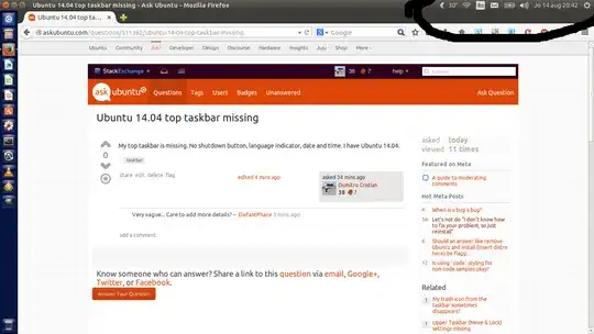

My top taskbar is missing. No shutdown button, language indicator, date and time. I have Ubuntu 14.04. See here what is missing.
See here what is missing when I'm logged in with another user
