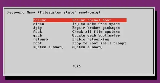

Restart the PC and Press and hold the
SHIFT
Key to get the Advanced options and choose Recovery mode
After reaching this screen choose
drop to shell
Drop to root shell prompt
Then Run the command
mount -o remount rw /
This will make the / as read and write
then do your installation steps
