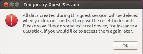

When the PCs are turned on, and the guest account logs in automaticcaly, the first thing shown after the window manager is loaded is this dialog box:
However, there's two problems:
  1. The very first person who sits at the computer at 9am will see the dialog box, click OK, use the PC, leave, not ending the session or locking the screen (because users), and the second user onwards won't see the message
  2. There is more relevant information that I'd like to convey for the lab users (lab rules, etc).
So, with this scenario in mind, what I want to achieve is having a dialog box really similar to this one (but with a different text, set by me) to popup whenever a computer isn't used for, say, 15 minutes. (For the purpose of this question, let's assume "not used" means no keyboard or mouse activity).

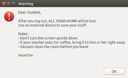

If you run the following script in the background, it will check the idle-time every 5 seconds. If the idle time exceeds a given amount of time (in minutes), a message will appear, defined in a textfile. (through a Zenity window).

  • For convenience reasons (and to have control over the text layout), the text is taken from an external textfile. Returns etc. will be copied exactly from the text file into your message. Since the --no-wrap option from zenity is used, you need to use the returns, or otherwise your message will be excessively broad.
  • The way the message appears can be "tweaked" with other zenity options.
