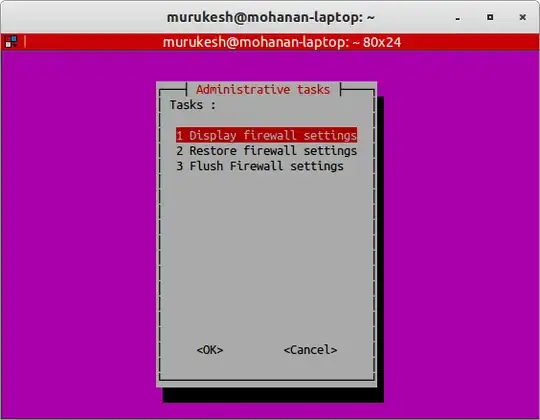

When I run this script it displays options in a menu style on my terminal and then runs the relavent command in the script.
Script Screen

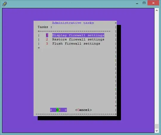

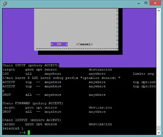

But when it exits the screen is messed up.
Is there a way to "save" the state of screen before I ran this and restore it?
Is there a better "Windows" scripting program that runs in a text screen?
Messed up Screen
