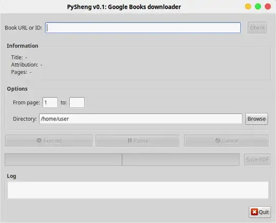

abcd
  • 443
There is a Python program called PySheng than did the job for me.
It's available on Github at https://github.com/tokland/pysheng
You can run the following commands to install it.
git clone https://github.com/tokland/pysheng
cd pysheng
sudo python setup.py install
Now PySheng will be available from the Termainl.
You can run pysheng-gui and pysheng from the terminal for the GUI and terminal version respectively.
pysheng-gui
PySheng GUI for downloading from Google Books
