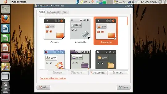

Now, I seem to be stuck with something that looks like Emerald but apparently isn't (see note below). Compiz is running, as is gtk-window-decorator, but my title bars aren't following Ubuntu's theme. I was using the Ambiance theme with no problems until the upgrade to Natty.
Here's a screenshot: Emerald theme

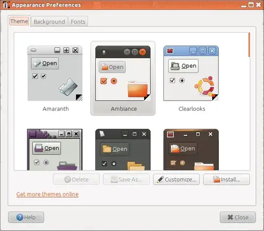

Following htorque's very reasonable suggestion to run unity --reset made matters worse. Now, after logging out/in, most of my theme-related stuff is gone entirely and can't be changed (clicking on the themes in the dialog changes the title bar/scrollbar color but nothing else). Here's a screenshot of the current situation:
Screenshot of the new situation
This doesn't seem to be Emerald, but an undecorated Metacity.
I worked this out using Ubuntu Tweak, since I forgot where the option was in gconf-editor.
If you haven't installed it yet, you can do so by:
sudo add-apt-repository ppa:tualatrix/ppa && sudo apt-get update
sudo apt-get install ubuntu-tweak
Once installed, open it up, and head to Window Manager Settings, under the Desktop section. Scroll down, and the option for "Use Metacity window theme" under Window Effects should be unchecked in your present condition. Check it, and it should bring up the correct theme. If not, restart Compiz.
