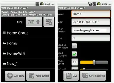

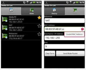

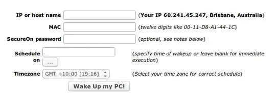

From any device with internet access you can wake-up your machine from internet or LAN (if enabled in BIOS and forwarded properly trough a router, if any) by means of magic packet. The proper wake up event must be enable in bios for a desired suspend state like S3/S4.
  • wakeonlan (Linux command line) A tool to send a Wake-On-LAN "Magic Packet"
sudo apt-get install etherwake
wakeonlan -i ipaddress
or this
