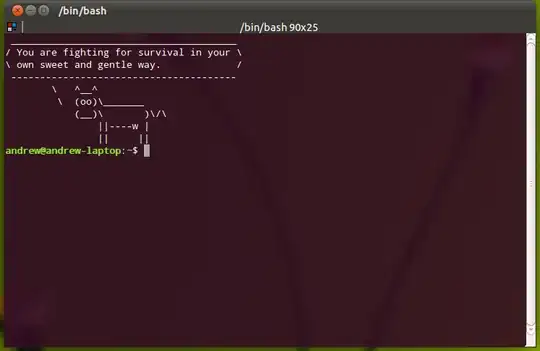

Now to get the ascii art and quote, you will need to install two packages:
sudo apt-get install cowsay fortune
Now in ~/.bashrc add a line with:
fortune | cowsay
Save the file, and restart your terminal (or resource the file with source ~/.bashrc).
mint-like bash prompt

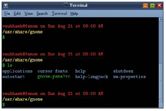

If add the following to your .bashrc file, you get color-coded date, time, username, hostname, and the current directory. Most importantly, you get the entire line to type your command.
PS1="\a\n\n\e[31;1m\u@\h on \d at \@\n\e[33;1m\w\e[0m\n$ "
