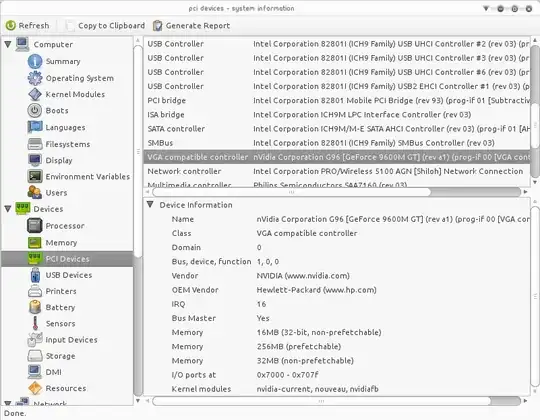

You can install hardinfo and browse the various categories of hardware to get info on which driver each device in the list uses.
Screenshot:
RolandiXor
