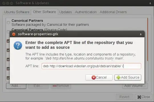

    3. Paste the following line into the text field:
      deb http://download.videolan.org/pub/debian/stable/ /
      Dialog for adding a package source
    4. Confirm by entering your password

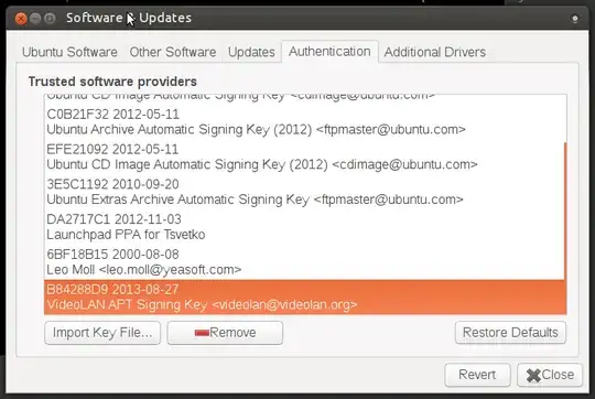

  4. Add the VideoLAN repository signing key:
    1. Switch to the Authentication tab
    2. Download this file to some location that you can remember
      (like your Downloads directory):
      http://download.videolan.org/pub/debian/videolan-apt.asc
    3. Back in the Software & Properties window click Import Key File...
    4. Select the file you have just downloaded and click OK
    5. How the Software & Updates window should look like:
      Software & Updates window after key import
