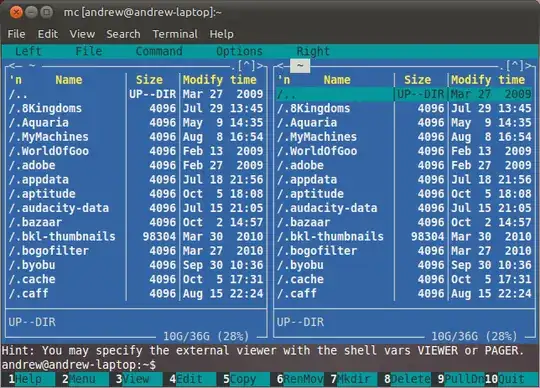

So while what you're after might not be completely possible with Nautilus, it's also worth mentioning that you can still use a "commander" in Ubuntu.
Check out Midnight Commander if console applications are your style.
sudo apt-get install mc
mc

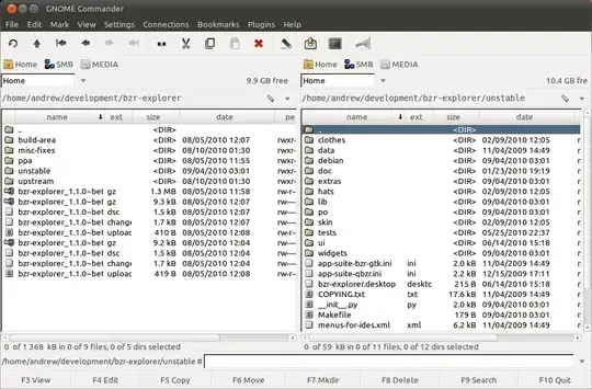

If you're looking for something that integrates into the desktop, try GNOME Commander. It's a two-pane graphical file manager in the "commander" style, with your familiar hot keys.
sudo apt-get install gnome-commander
gc

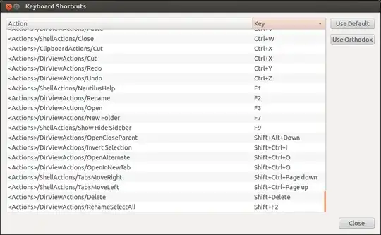

Yet another way to define arbitrary hot keys is by using the Nautilus extension API although it is not quite designed for that. As a proof of concept I've developed this extension which defines the following hot keys:
  • F5 to copy selected files/directories to another panel
  • F6 to move selected files/directories to another panel
  • F7 to create a directory in the active panel
  • F8 to delete selected files/directories
  • Ctrl+O to open terminal in the current directory of the active panel (only works for local filesystem)
You can even configure the shortcuts manually in the Keyboad Shortcuts window provided by this extension:
Unlike the can-change-accels solution, this one works fine with global menus.
