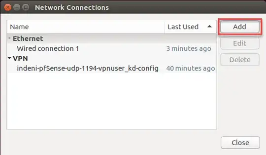

click Add:
add new connection

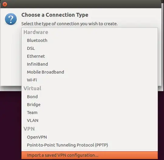

In the dropdown, select to import the vpn config:
import saved vpn config

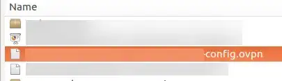

Select the .ovpn config file from your file system:
choose vpn config

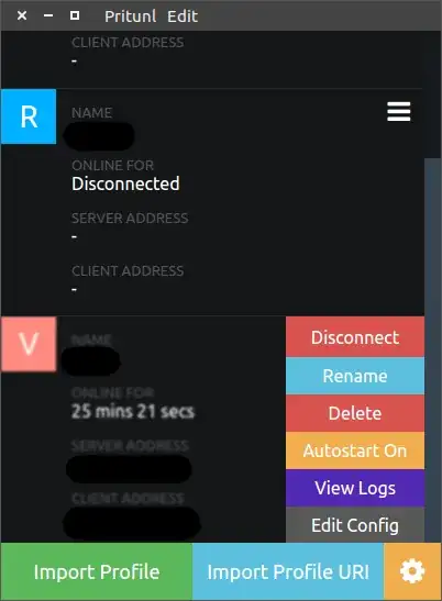

You could try free and open source Pritunl client
https://client.pritunl.com/
To install it on Ubuntu 16.04:
