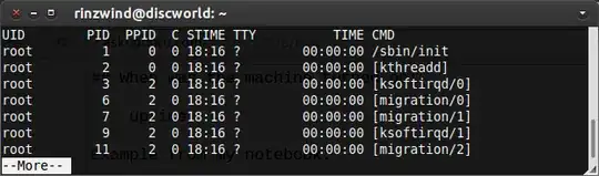

What programs run:
  • Command line
    ps -ef|more

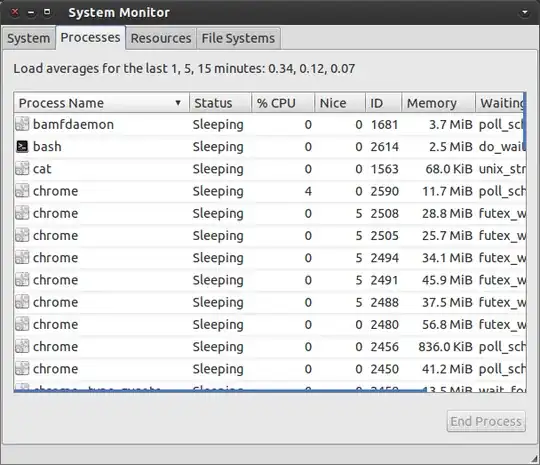

  • GUI - System monitor (dash, system monitor):

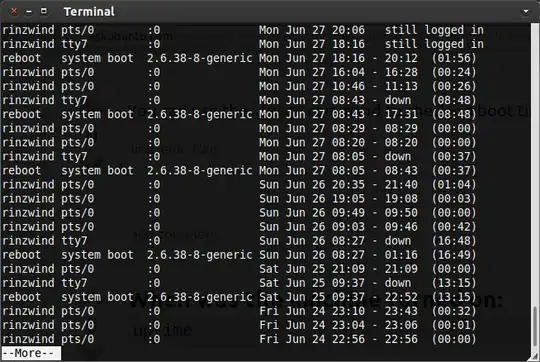

When the computer was resumed or sleep
last

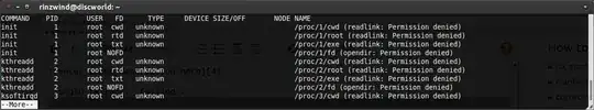

  • lsof shows a list of currently open files.
    It can do alot of checks on a lot of options. From man lsof:
    To list all open IPv4 network files in use by the process whose PID is 1234, use:
    lsof -i 4 -a -p 1234
    To list all open files for login name ``abe'', or user ID 1234, or process 456, or process 123, or process 789, use:
    lsof -p 456,123,789 -u 1234,abe
    To list all open files on device /dev/hd4, use:
    lsof /dev/hd4

You can use the last command to check on boot times, reboots, suspends/resumes.
