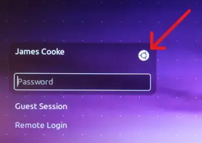

You need to switch desktop environment at login. Logout (or reboot) to change it.
