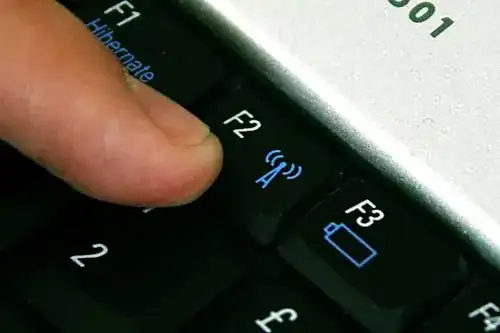

Just look for your wifi key on your keyboard (near the function keys).
Mine was PrtScr (Hit Fn + PrtScr to turn it on).
If you can't find it you can also attach a keyboard which has the wifi key to your laptop.
symbolic picture of wifi key
