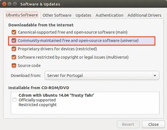

Package tree is available in Universe. Check that you have it enabled:
Then just do the usual
$ sudo apt-get update
$ sudo apt-get install tree
All Ubuntu repositories (main, universe, restricted, multiverse) can be enabled by following command:
sudo add-apt-repository "deb http://archive.ubuntu.com/ubuntu $(lsb_release -sc) main universe restricted multiverse"
