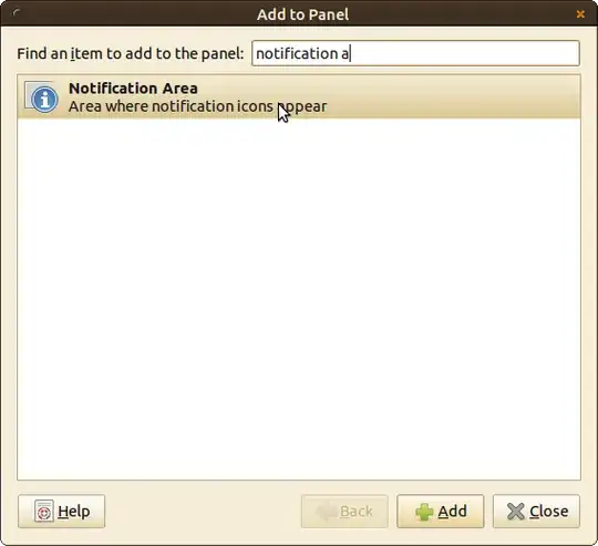

Add the notification area to your panel. You do so by right-clicking on the panel, "Add to Panel..." and choosing Notification Area:
This gives you the network manager applet (nm-applet), the sound / volume chooser and the battery indicator.
