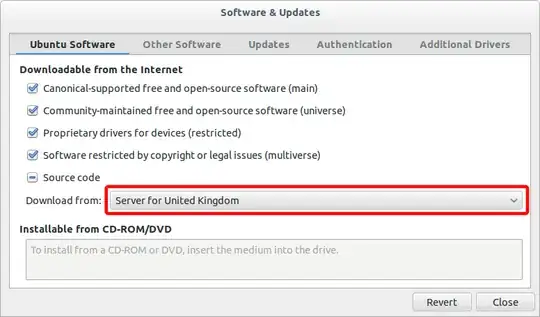

I live in the UK, so it should be better to use the UK ones. But, the USA one is more likely to be well maintained and have the better connection speed.
Which should I use - is there a testing tool, either built in or installable?
I, personally, would prefer a GUI method over command line.

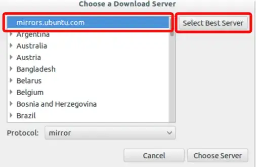

There is a built in utility in Ubuntu to find the best server.
Click on the drop down to change the server.
Scroll up to the top and select the top one (mirrors.ubuntu.com). Then click Select Best Server.

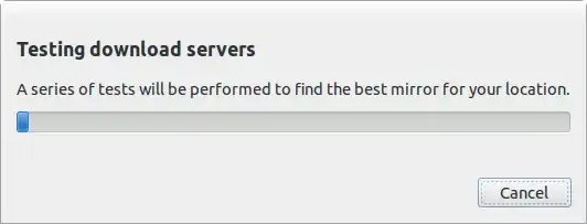

Wait for the tests to finish (about 45 seconds).

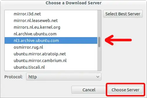

It will select the best one for you. Click Chose Server.
Enter your password. It will have changed.
