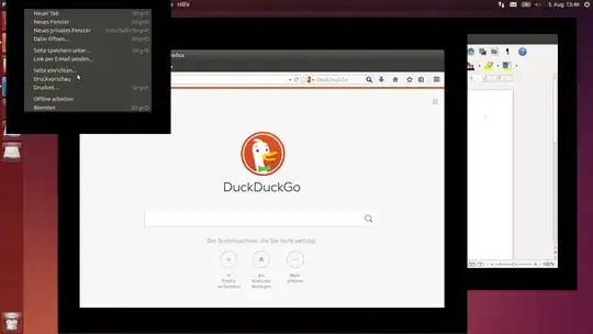

when my 64bit Ubuntu 14.04 machine "wakes up" after hibernation, windows look like this:
gigantic borders on all the windows
The system is still usable, but it's really ugly and I believe that Linux is beautiful, not only because of its command line, but also because of its GUI. So there must be a solution for this.
I am using a Samsung R780 laptop, Nvidia GeForce GT 330M graphics card, Intel® Core™ i7 CPU M 620. I have a separate swap partition set up and I'm running the x.Org server with Unity 7.2.0 on top. I'm using the evil ;) Nvidia proprietary driver version 331.38, because open drivers don't work for me. Do you need any additional information?
When I restart the x-server and display manager, everything works fine again.
I didn't find anything on the web and I don't have a clue what could possibly cause this problem, so I'm very thankful for any help.

This is a known bug in Ubuntu 14.04 => https://bugs.launchpad.net/ubuntu/+source/compiz/+bug/1292830, please vote for it by clicking the green text at the top of the page that says "This bug affects 69 people, but not you".
A temporary workaround is to go into a system terminal mode, careful with this as you need to know how to get back to the Unity desktop otherwise you will have to restart.
  1. Press Ctrl + Alt + F6 (takes you to system terminal mode)
  2. Press Ctrl + Alt + F7 (takes you back to the Unity desktop)

Answered by OP in comments.
Seems like I messed up my compiz configuration when upgrading to 14.04. Thanks to user164089 and this post, I tried resetting my compiz settings and it works.
