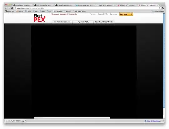

I've been building a website for a guy who uses Mac OS X and occasionally he sends me screenshots of bugs. They come out looking like this:
A pretty screenshot
This is fairly typical of Mac screenshots. You get the window decorations, the shadow from the window and a white or transparent background (not the desktop wallpaper -- I've checked).

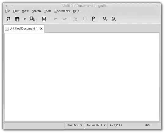

Compare this to an Ubuntu window-shot (Alt+Print screen):
It's impossible to keep a straight face and say the Ubuntu one anywhere near as elegant.

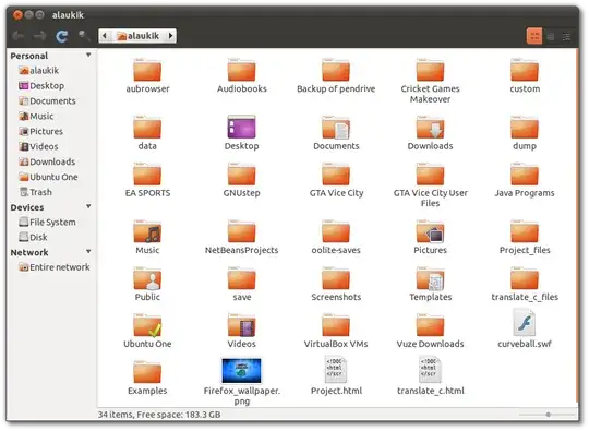

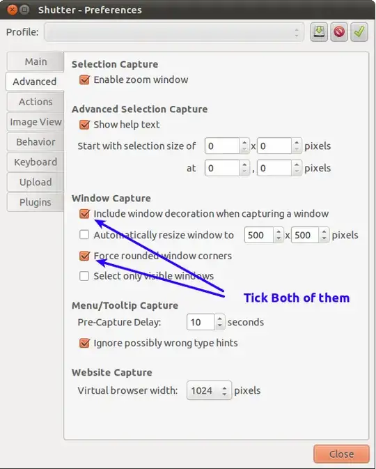

Using Shutter
  • First go to Edit -> Preferences and tick the two options mentioned below .
  • Now Take the screenshot of a window and right-click and select run a plugin .
  • Now select Hard Shadow and run it .
  • Your Final Screenshot will look like this .
Pretty Screenshot!

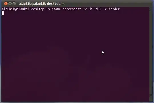

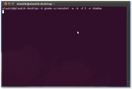

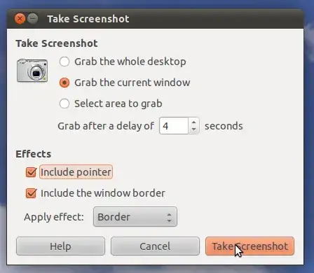

Using gnome-screenshot
  • Launch 'Take Screenshot' from the dash and select 'Include the window border' with the Effect Drop 'Shadow' or 'Border' and then take the screenshot.
  • To do the same using the terminal ( Ctrl + Alt + T ) paste
    gnome-screenshot -w -b -d 5 -e border
where 5 is delay in seconds and border can be replaced with shadow for 'Drop Shadow' .

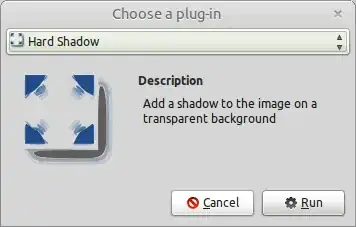

Shutter install shutter

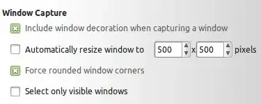

You can achieve this in Shutter. To grab a whole window, including decorations, you can right click on the notification icon then click 'Window under Cursor' or from the application window, click the window icon (4th from the left in the toolbar). You can then select a window with your mouse to take the screenshot of that window.
To make rounded window decorations look better, go into Edit->Preferences, click the 'Advanced' tab and tick 'Force rounded window corners'.
Force Rounded Window Corners

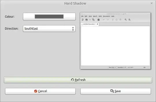

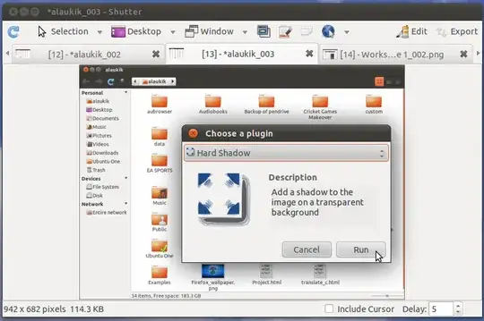

To add a shadow effect, once you have taken a screenshot, click Screenshot->Run a Plugin... and choose 'Hard Shadow' then click 'Run'.
Choose a plug-in
You can then edit the options for the shadow and click 'Save' to apply the effect.
Hard Shadow
The end result looks something like this:
