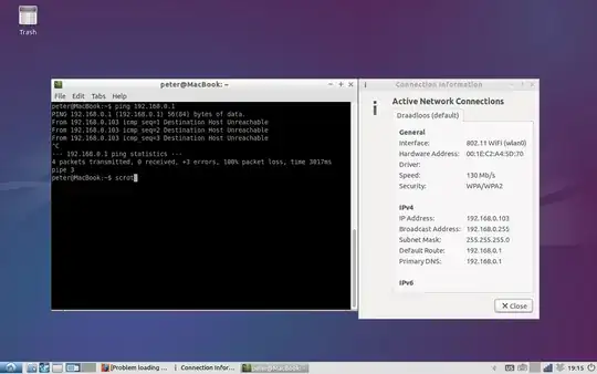

I am able to connect to the router as shown in the picture below, but somehow I can't use the connection. I can't even ping to the router itself, while the laptop is showing up in the DHCP list of connections with the correct MAC address and the same Assigned IP address as you can see in the picture.
I am completely lost at to what the problem might be. Anybody knows where the problem might lay?!
enter image description here!

Do:
sudo apt-get purge bcmwl-kernel-source
Then:
sudo apt-get install linux-firmware-nonfree
Reboot and let us have your report.
