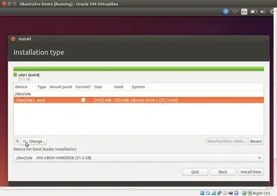

  1. On the Something else screen (image below), highlight each of your partitions and click on the - minus sign. This will delete the partitions.
