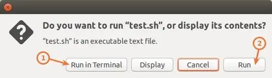

In Nautilus you have two options to run a script when you double click on it:
Run a script from Nautilus
1. Run in Terminal
  • Using this option, your script will run correctly (as you said).
2. Run
  • Using this option you have to use pkexec (or gksu if you have it installed) instead of sudo. That is because you can't run graphical commands which use sudo without to use an X terminal emulator, even if you set sudo to not ask for password.
  • So, in this case, your script should look like:
