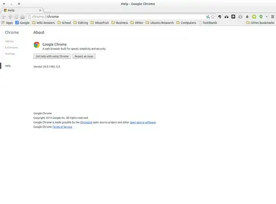

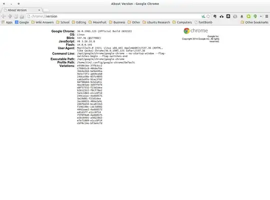

And then there are the gui methods:
You can go to the following sites:
chrome://chrome
gives you this:
And
chrome://version
or
about:
Thanks Jeff Inventor Chrome OS.
gives this:
Google Chrome   36.0.1985.125 (Official Build 283153)
OS  Linux
Blink   537.36 (@177902)
JavaScript  V8 3.26.31.8
Flash   14.0.0.145
User Agent  Mozilla/5.0 (X11; Linux x86_64) AppleWebKit/537.36 (KHTML, like Gecko) Chrome/36.0.1985.125 Safari/537.36
Command Line    /opt/google/chrome/google-chrome --no-startup-window --flag-switches-begin --flag-switches-end
Executable Path /opt/google/chrome/google-chrome
Profile Path    /home/tim/.config/google-chrome/Default
Variations  e950616e-37fb3cc2
            c70841c8-4866ef6e
            3664a344-be9e69ba
            9e5c75f1-ad69ceb0
            24dca50e-837c4893
            ca65a9fe-91ac3782
            8d790604-9cb2a91c
            4ea303a6-3d47f4f4
            d8f57532-f23d1dea
            b2612322-f8cf70e2
            5a3c10b5-e1cc0f14
            244ca1ac-4ad60575
            5e29d81-f23d1dea
            3ac60855-486e2a9c
            246fb659-bca011b3
            f296190c-cdc3d902
            4442aae2-4ad60575
            ed1d377-e1cc0f14
            75f0f0a0-4ad60575
            e2b18481-a5822863
            e7e71889-e1cc0f14
            cbf0c14e-bf3e6cfd
