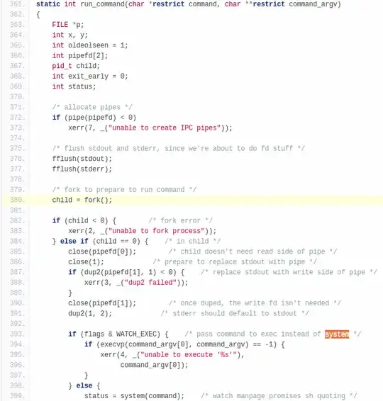

To find the answer we need to look at the watch command source code.
  1. You can see two watch processes because watch forks (line 380) a new process each time it has to run the command:
  2. The extra sh process is here because watch calls the system() function (line 399) and by default it runs the specified command with /bin/sh -c. Look at the system man page:
