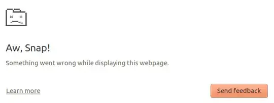

Ever since I upgraded to Ubuntu 14.04, Chrome (google-chrome-stable) crashes a lot more often than before.
I do keep several tabs open (>20), but they are all light (no multimedia) and have never caused any problems in the past.
The processor and memory use is pretty low when the browser becomes unresponsive and the whole system is still usable.
Is there an easy fix? Where can I find more logs for a more complete diagnostic?
