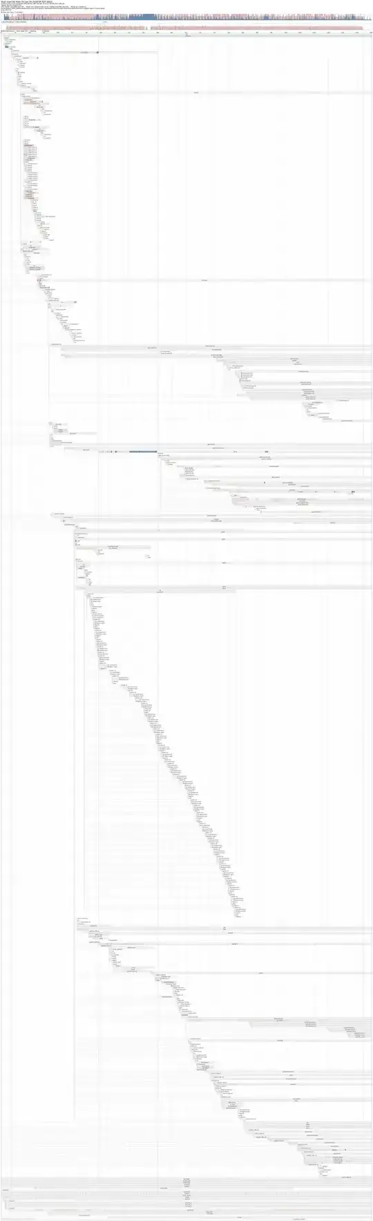

Here is the requested bootchart without the advantage of a packed boot: enter image description here

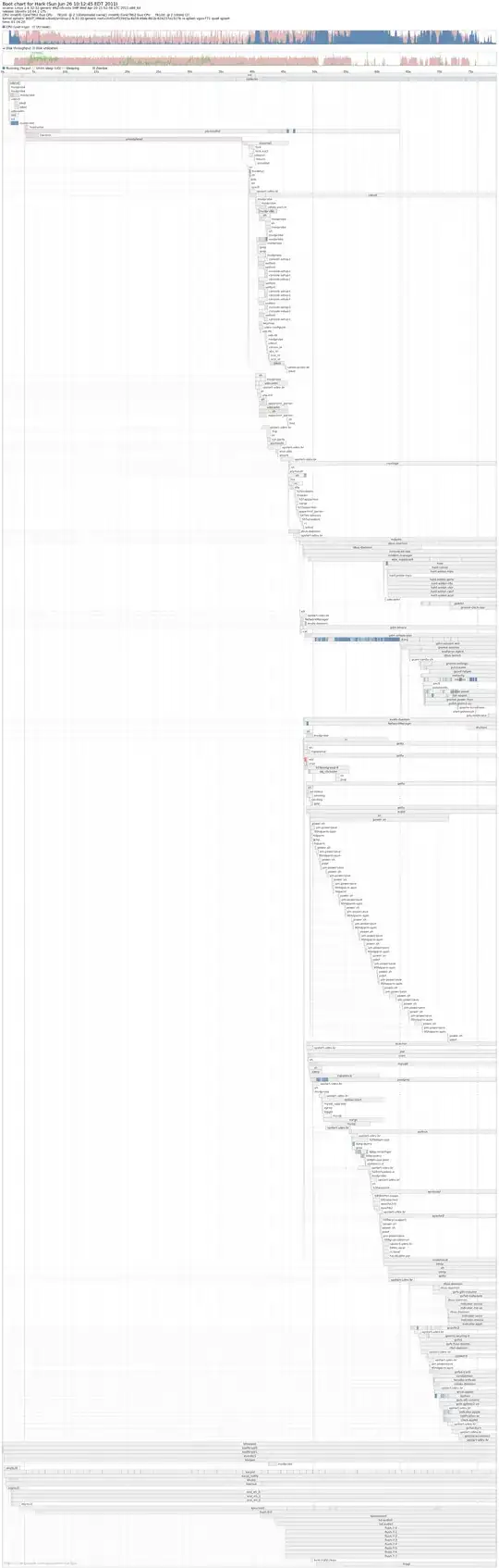

Here is a bootchart with the advantage of a previously packed boot: enter image description here
