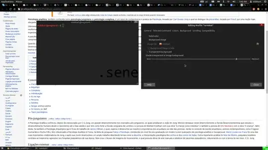

I rebooted my computer and after some changes with Ubuntu Tweak on my window manager theme, etc., I came with this problem in my Terminal.
Before the reboot, I could see the things behind the terminal perfectly, but now the transparency seems to be only working with the desktop background (as shown a part in the picture). How can I solve this problem? Thanksenter image description here

Did you try clicking on edit --> preferences and select the appearance tab and change the background transparent to none (solid color)?

Try to override this terminal setting with CCSM (Compiz config settings manager) in opacity, brightness and saturation -> windows specific settings click new and plus button, chose window class and then grab button click on open terminal window and set value e.g 75 for opacity.

Open a terminal window (Alt+Ctrl+T) and type the following line:
gsettings set org.gnome.metacity compositing-manager true
