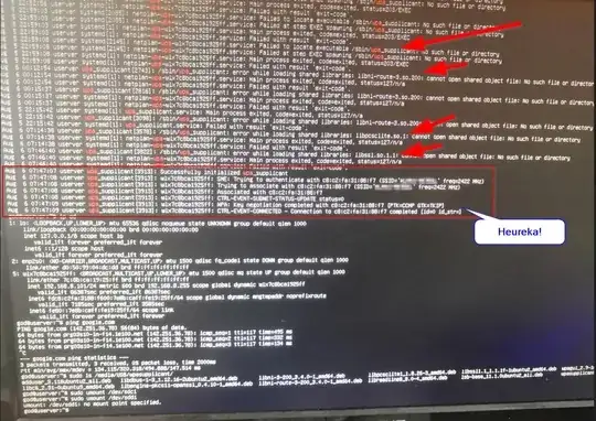

I did download it from https://ubuntu.pkgs.org/ . After installation I'm able to connect to internet via WiFi. The server wasn't connected to internet before, its brand new install. It's possible to check what exact package you need to install if you check logs with command grep wpa /var/log/syslog. You will see errors like on the screen below which indicates what package is missing.
