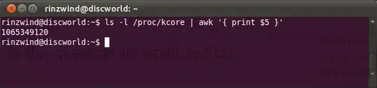

As you can see the way they calculate it in this package depends on the size of /proc/kcore, then gets divided by 1048576, +1 to round it up and then gets multiplied by swapfactor. From my machine:
So the default for this system would be 1065349120 / 1048576 = 1015+1 = 1016 * 2 = 2032 MBytes.
